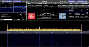

Local Storage
Remote SDR saves your last chosen configurations, such as USB mode, frequency band, audio level etc., in the local storage area of the web browser. This allows you to find the configurations when your system restarts.
Locally stored settings page in browser console (Ctrl+Shift+I)
Issue
The web page loads incompletely due to errors, the SDR RX On light does not turn green. This follows an update, changes to the configurationRX.js or configurationTX.js files.
Inconsistent page after loading
Solution
Go to the “Tools” page and select “Reset Local Storage in browser” at the bottom of the page. This resets all initial settings and avoids configuration conflicts.
If the “Tools” page does not load correctly, go to the console (Ctrl+Shift+I) and clear all settings under the application/local storage tab.
Please note, following a “Reset Local Storage in Browser”, the “Access Key” key must be returned to the “Settings” page to be able to send. By default, it is equal to ‘1234’ unless there is another value in the /remsdr/AccessKey.txt file.

  1. Stefan
    Hallo Andre:
    I have great problems with my Raspbbery PI 2Gb and Adalm Pluto Plus to get work.
    I have never seen a green RX or TX “LED”.
    When I write the correct IP adress in form, then the screen will “flasch” and the IP adress in “Parameter” will clear automatically. In tools the RX were listed under UDB devices correctly.
    I have tested with LAN connection and:
    WIN7 + Chrome with changed Flags and Firefox
    Linux MINT with Firefox
    Raspi 4B 2 Gb Image 4.4 and 4.5 with:
    Pluto PLUS: Analog Devices, Inc. PlutoSDR (ADALM-PLUTO)
    Realtek Semiconductor Corp. RTL2838 DVB-T
    Dexatek Technology Ltd. DK DVB-T Dongle
    All tested with different USB Wires on USB 2.0 and USB 3.O.
    What’s going wrong here?
    best regards
    73, de OE1NHU
    Apache Server Errors:
    [Thu Nov 18 17:44:21.435836 2021] [mpm_event:notice] [pid 5167:tid 3069936064] AH00489: Apache/2.4.51 (Raspbian) configured — resuming normal operations
    [Thu Nov 18 17:44:21.436310 2021] [core:notice] [pid 5167:tid 3069936064] AH00094: Command line: ‘/usr/sbin/apache2’
    [Thu Nov 18 17:48:48.866212 2021] [mpm_event:notice] [pid 5167:tid 3069936064] AH00492: caught SIGWINCH, shutting down gracefully
    [Thu Nov 18 17:48:48.967744 2021] [mpm_event:notice] [pid 5653:tid 3069239744] AH00489: Apache/2.4.51 (Raspbian) configured — resuming normal operations
    [Thu Nov 18 17:48:48.968244 2021] [core:notice] [pid 5653:tid 3069239744] AH00094: Command line: ‘/usr/sbin/apache2’
    [Thu Nov 18 17:53:20.943948 2021] [mpm_event:notice] [pid 5653:tid 3069239744] AH00492: caught SIGWINCH, shutting down gracefully
    [Thu Nov 18 17:53:31.305453 2021] [mpm_event:notice] [pid 618:tid 3069915584] AH00489: Apache/2.4.51 (Raspbian) configured — resuming normal operations
    [Thu Nov 18 17:53:31.315798 2021] [core:notice] [pid 618:tid 3069915584] AH00094: Command line: ‘/usr/sbin/apache2’
    Traceback (most recent call last):
    File “/var/www/html/cgi-bin/SelectRadio.py”, line 23, in
    s.connect((HOST, PORT))
    ConnectionRefusedError: [Errno 111] Connection refused
    ….. and so on.
      Stefan
      Go on the Tools Page
      1) Do you see the Pluto when you « List USB Devices » ?
      2) Is the pluto responding when click on « Pluto Help »?
      3) Reset Local Storage in Browser
      4) Open the browser console Ctrl+Shift I, to see the error messages
      5) Don’t use Firefox. Use only Chrome or Edge
      Hope you do not have the same issue as an other OM last week. One file on the SDcard was corrupted. After reinstalling the source everything was OK.
      If you still have an issue. I can control your PC with the « Remote Assistance » of windows to inspect the Raspberry.
      f1atb.fr@gmail.com
      1. Stefan
        Hallo Andre:
        Was the correct answer! Now it works fine!
        THX!
        73, de Stefan OE1NHU
