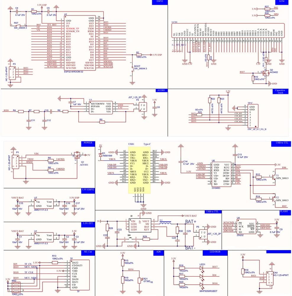

Affectation des GPIO
GPIO
To expand the number of GPIO pins, you can easily repurpose those used for the micro-SD memory card if you’re not using it (shown in yellow in the table). You can use a “Card-Sniffer,” available on AliExpress. It’s a dummy memory card that provides the GPIO pins.
The metal casing of the bracket can also be desoldered to access the four GPIO pins used to control the SD card. Then, 2.54mm pitch Dupont pins can be soldered, attaching the assembly to the solder points on the casing on the sides.
Brochage Micro-SD et GPIO correspondants
Les connecteurs sur la carte sont des JST 4 broches 1.25mm
LDR Ambient Brightness
On the front of the board, there’s a variable resistor that adjusts with brightness. Its supply resistance is too high. It needs to be reduced to achieve good analog measurement dynamics on GPIO 34. Solder a 20 to 47k ohm resistor in parallel with R15. This way, by measuring the voltage on GPIO 34, you can integrate a brightness measurement into your program.

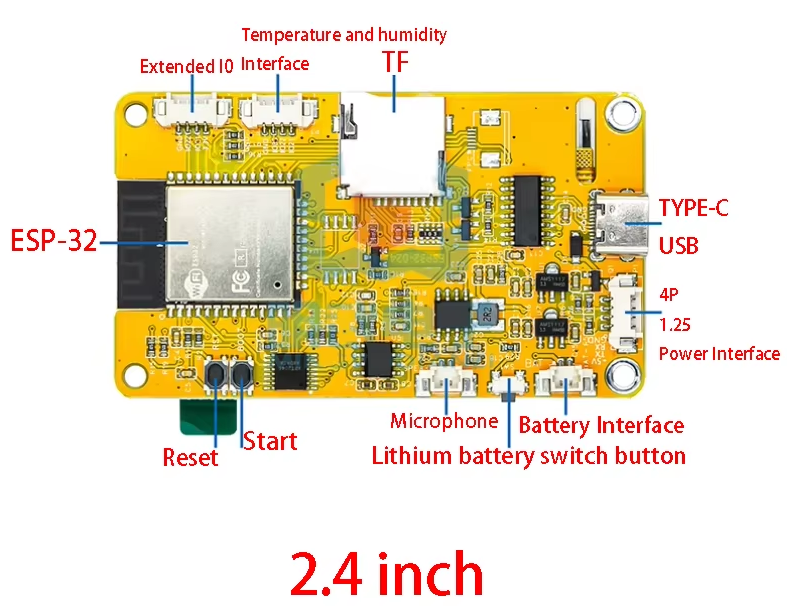

ESP32-2432S024
This family of 2.4-inch cards features either a resistive or capacitive touchscreen (capacitive is preferable). The screen is either an ILI9341 or ST7789.
For the GPIO pins, only 3 are available: 21, 22, and 35. Note that pin 35 is only an input pin. As in the previous example, we can retrieve the GPIO pins that control the micro-SD connector.

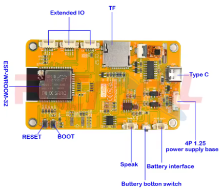

JC2432W328
This is the most interesting board with a 2.8-inch screen, a capacitive touchscreen (more practical than resistive), and 6 available GPIO pins. However:
GPIO 4: Turns on the red LED with a 0. Best used as an output.
GPIO 16: Turns on the green LED with a 0. Best used as an output.
GPIO 17: Turns on the blue LED with a 0. Best used as an output.
GPIO 21: As an input or output.
GPIO 22: As an input or output.
GPIO 35: As a digital or analog input.
Alimentation
It is possible to power the board via the micro-USB port or via the 4-pin connector next to it with a power supply that provides 5V and 700mA minimum.
WARNING: With these boards, a screen that’s fully powered on and Wi-Fi enabled can draw significant current. If the power supply can’t keep up, the ESP32 will malfunction and leave you confused..

On GPIO26, there is a small amplifier allowing you to connect a small 4 or 8 ohm speaker, in order to send audio signals if needed.
