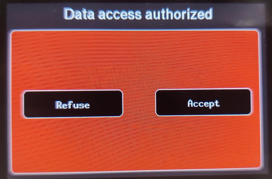

Access Authorization
To prevent unauthorized access by others on your WiFi network, an authorization request will appear on the Gluco-Monitor screen.

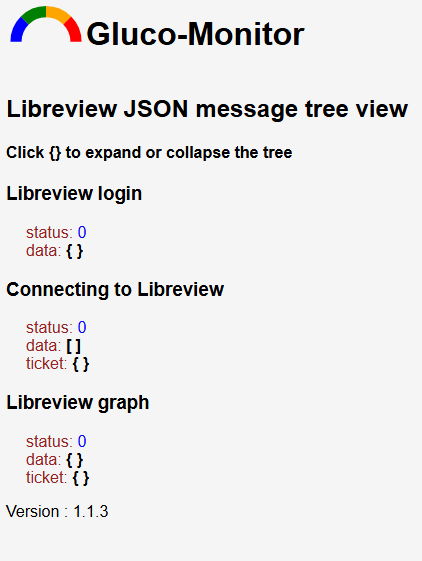

Libreview Messages
This section displays the responses to the three types of data requests, which is useful for troubleshooting. Click on the {} icon to expand the data tree.
- Login: Authorization request.
- Connection: Returns the patient’s most recent glucose reading.
- Graph: Returns a table of glucose readings over approximately the last 10 hours.

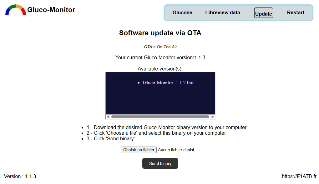

OTA Update
This section provides access to a list of the latest Gluco-Monitor software versions. You can select and install your preferred version over WiFi.
- OTA : On The Air
