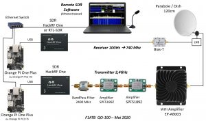

The set is made up of:
- a reception chain: SDR (Software Design Radio) + an Orange PI nano processor
- a transmitter channel: SDR + an Orange PI nano processor
- a PC or a tablet controlling the whole with “Remote SDR” running on a web browser like Chrome or Edge.
