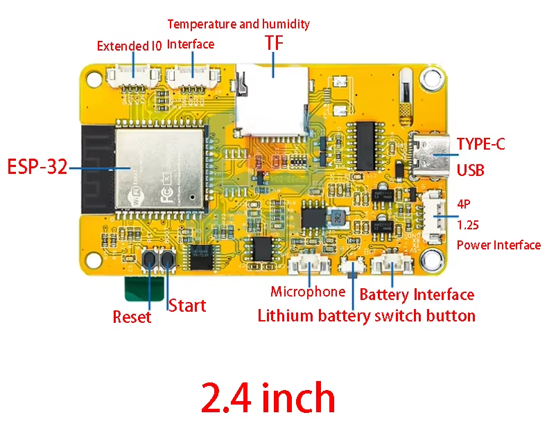

ESP32-2432S028R
Brochage Micro-SD et GPIO correspondants
Les connecteurs sur la carte sont des JST 4 broches 1.25mm
ESP32-2432S024
Power Supply
It is possible to power the board via the micro-USB port or via the 4-pin connector next to it with a power supply that provides 5V and 500mA minimum.
Speaker
On GPIO26, there is a small amplifier allowing you to connect a small 4 or 8 ohm speaker to send audio signals if needed.
