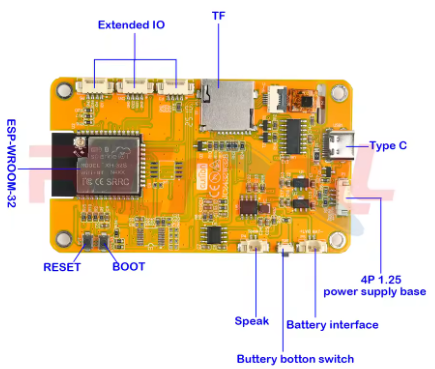

JC2432W328
This is the most interesting board with a 2.8-inch screen, a capacitive touchscreen (more practical than resistive), and 6 available GPIO pins. However:
GPIO 4: Turns on the red LED with a 0. Best used as an output.
GPIO 16: Turns on the green LED with a 0. Best used as an output.
GPIO 17: Turns on the blue LED with a 0. Best used as an output.
GPIO 21: As an input or output.
GPIO 22: As an input or output.
GPIO 35: As a digital or analog input.
